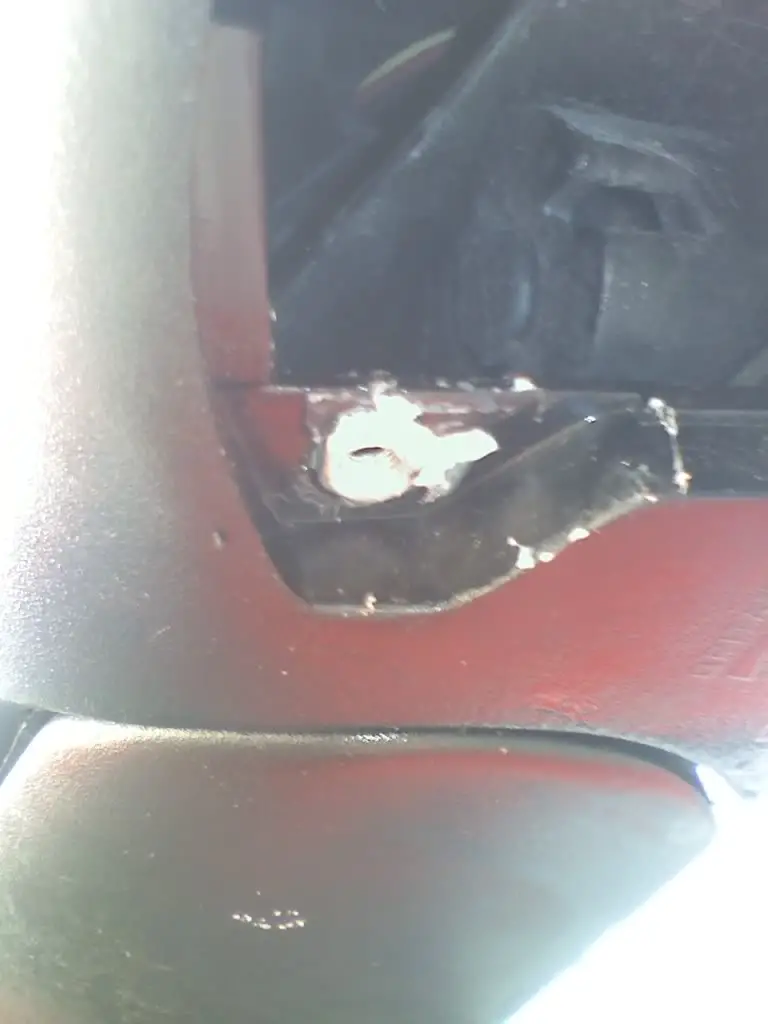

My puddle lights were dead and went to replace them and couldn't get the bolts out. They were rusted shut.
So I drilled them out
And drilled out the hole in which the plastic piece that held the bolt was. I then dropped in and glued in a stainless steal bolt, and used stainless steel bolts to tie it back up again.
worked well. now my both my lights work again
Just thought I'd share.
