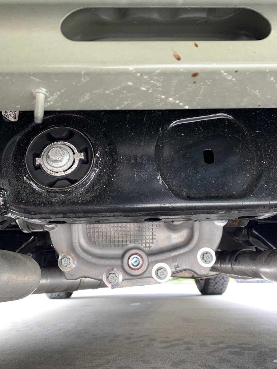

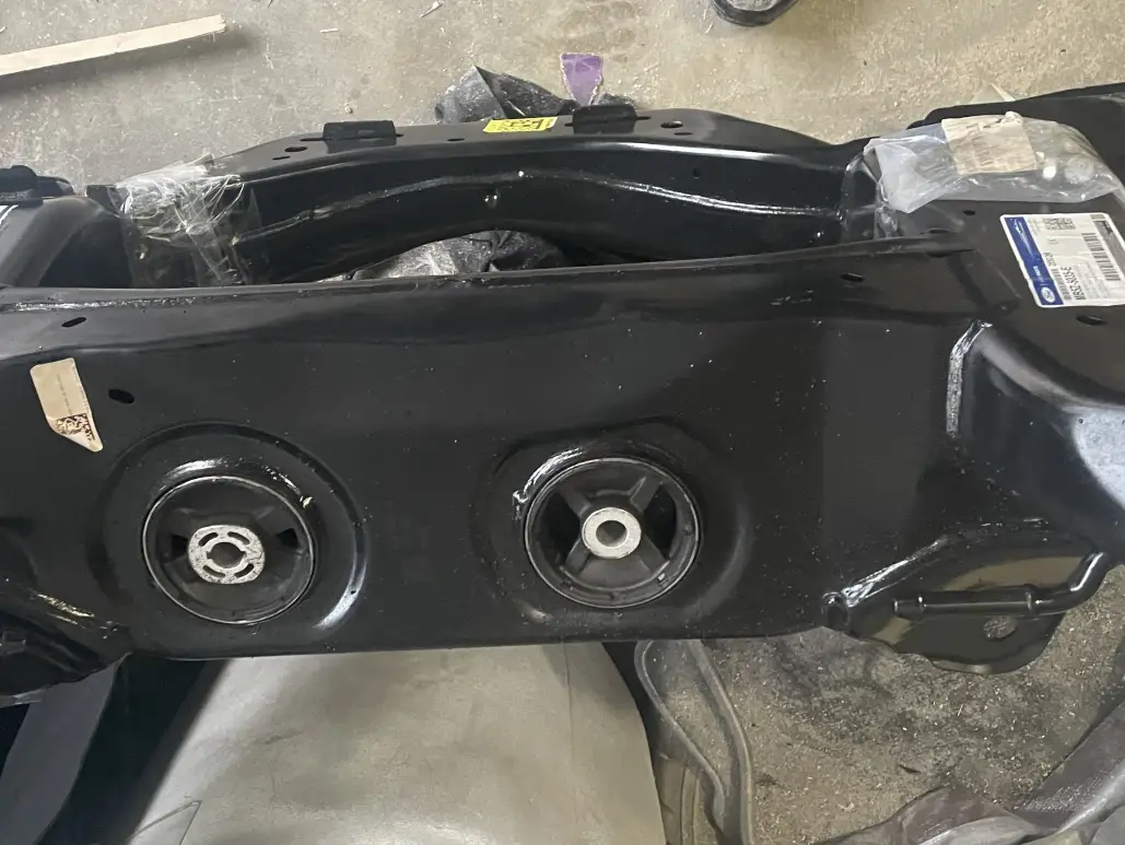

All 2.3 models have the 1 bolt in the rear, it was early 3.0L models the had the 2 bolt rear , then were moved to the same 2.3L 1 bolt sub frame. This recall likely only encompasses the V6 models. The bolt can not just be added it is a new subframe, not a cheap or quick task.I went by my local ford dealership, to check and see if all the explorers on the lot were missing the bolt, sure enough all of them were missing it. I noticed a couple with a build date as recently as of 4/1.
