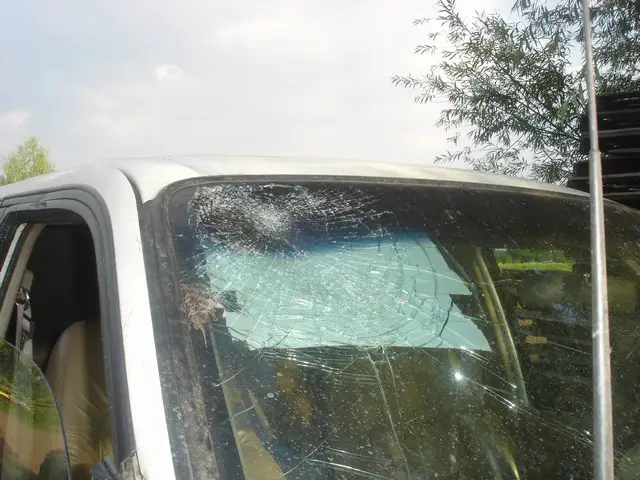

Carnage report: Broken windshield when I bumped into a tree and the top fell off and into/almost through the windshield.

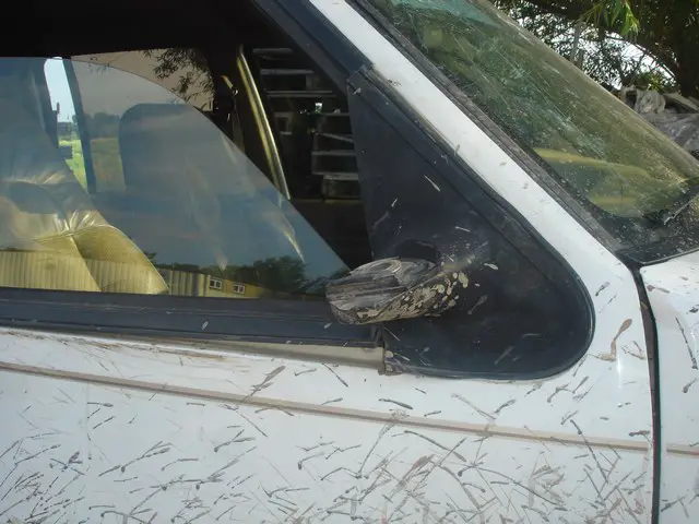

Tore off the pass mirrorwhen I got a little to heavy on the skinny.

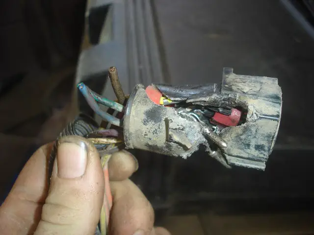

more
The pic of the windows is how far they close after the damage to the doors, time to beat them back into shape.

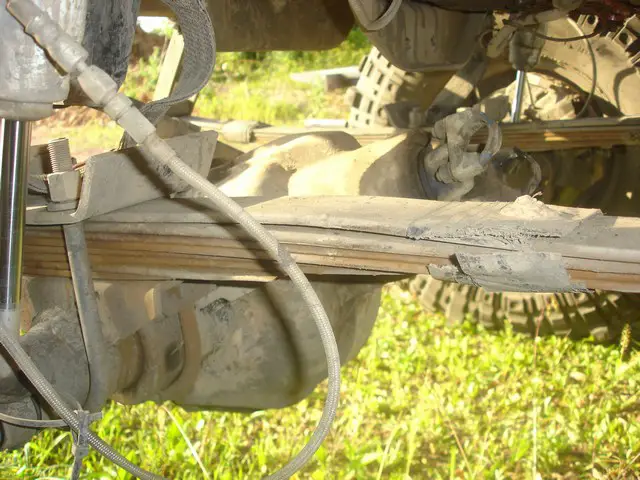

I also just saw I bent a leaf spring sometime during the day.
