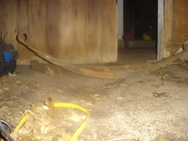

those waggy leafs stock, 4" lift, 6" lift, what?
Most run stock Waggy leaves, but I think I've seen someone run 2.5".
Mine are custom alcans based on the stock waggy leafs with 8 3/8" rise. I have about ~5-6" of lift over stock.

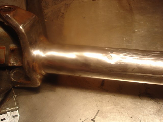

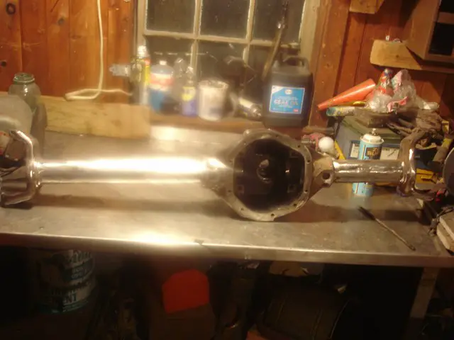

Updates for everyone. Housing is almost cleaned up and ready for paint. Still debating over por-15 or bedliner for painting the housing. Also did some searching today at work and scored 7-leaf waggy springs for free :p Those are hopefully getting blasted on saturday along with everything else. Trying to find hi-steer knuckles for steering, going OTT heimed crossover with cromo tubing that we have at the shop. AS far as getting it done, im hoping to order in my new gears (yukon 4.88's) for the rear and tires (35" mt/r's or x-terrains) within a month. Once they are in and the axle has steering completed im gonna get working on it. It will just be the housing till i can get in the gears for it, but they should come soon. Definatly before crozet.

few more, check back on first post for updated list of prices and estimates.

Lookin' good!!!! My SAS was never that clean! I Pm'ed you about some flat top knuckles, LMK if you're interested, thanks.
wow that is one shinny axle.....looking good so far.
.....ooooooo, shiny metal object...i can't seem to look away......:D
linds, if you say anymore about shiny metal things im gonna start callin you parrot. it is a lil shiny i guess :rolleyes: I got a lil carried away with a fine grit flap wheel. Its still going to get painted over, unless I want to roll on dubs and crome plate the axle... Hmmmmm.... :D Zainy, thanks for the offer, im gonna look into that.

You should start looking into getting bushings pressed into those waggy leaves. I always went to interstate springs in chester.
im ordering the bushings tommorow, we will prolly do em at the shop, if not Ill check that out.
You can do them as long as the shop as a pretty hefty press. I know interstate uses a 100 ton press but they also do some pretty BIG things
Ive pressed in spring bushings on a 20 ton press. Tried pressing them in with a jack under an 80 horse JD tractor, the picked the tractor up and didnt go in. :eek:
i could try that under our JD 7400 series... but I dont have a jack big enough.
