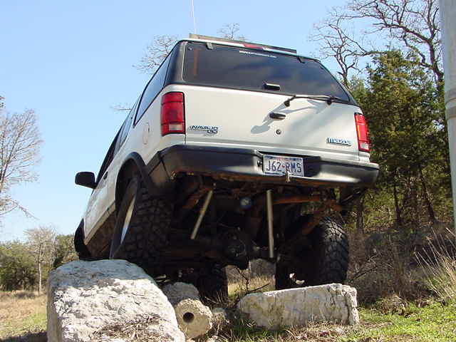

Day after I bought it for $1000
With 30-9.50's
With coil spacers and shackles with 32-11.50's
2" springs with Warrior shackles 3" BL and 35-12.50's
3" BL and 6" of Superlift and Skyjacker extended radius arms, with SOA
It has also been converted from an automatic to a 5spd standard with LUK custom heavy duty clutch, next serious mods are a 8 point roll cage 4.56 gears (5.13's would be nicer) and a pair of sliders, and of course finish all the other little stuff like relocating the battery to the rear and either using an F150 rear gas tank or fuel cell center mounted where the spare tire would originaly be mounted.
Purchacing the door hinge repair kit so I can make my doors removable. :wink:
Then I guess well see about saving for a winch.

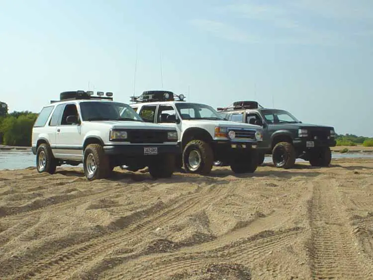

Thanx, looks like you live mighty close to the infamious "Slabs" we used to goto about twice a month!

I take it that's your 9L svo in the background in two of the pics?? 85.5 or 86? how stock is it?

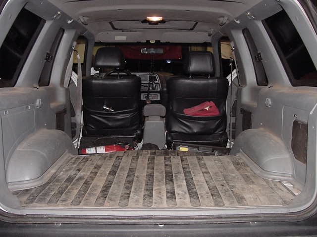

Here are some interior shots that I had left out.
:confused:

Quick question- do you like the interior w/o the carpet? I have been thinking of doing that for some time. What did you do with the wires on the drivers side? Do yuo have a mat in the rear?
Thanks,
Kirby
Kirby N. said:
Sorry, but your mask is lame.
Sorry Kirby,
It was halloween you know how that goes.
As for the no carpet thing, as you prolly noticed I burried the truck in the river so seats, sound deadening, carpet all smelled like rotting arse and had to be removed.
Do I like it? Well I don't have to vacuum it every weekend infact I havent had to clean it period.
As you will notice in the back the rubber floor covering is a bed mat out of a 1992-96' F150 Flareside that no body wanted and I laid in there, it actually keeps the studs for the back seat from poking into my air matress when we go camping.
As for the wires, they just are sitting there like they have been, they don't get in the way nor move around.
