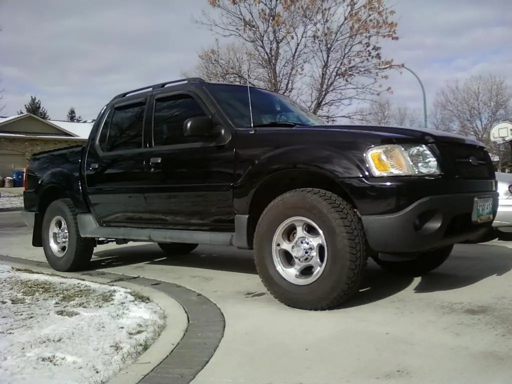

Here's mine at stock height with 265/70/16's, no trimming needed...
picture.php

With 75's you'l need to do some trimming but shouldn't need to lift it.
If you're fine with trimming, get the 265/75. If not, get the 265/70. But if you ever think you would want to lift in the future get the bigger ones. Looks so much better with that extra inch of sidewall

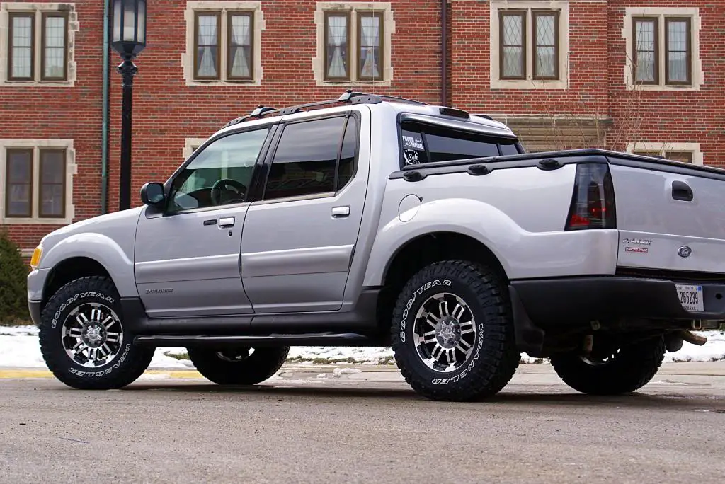

My old '05 with 265/75's and a TT/shackle lift.
