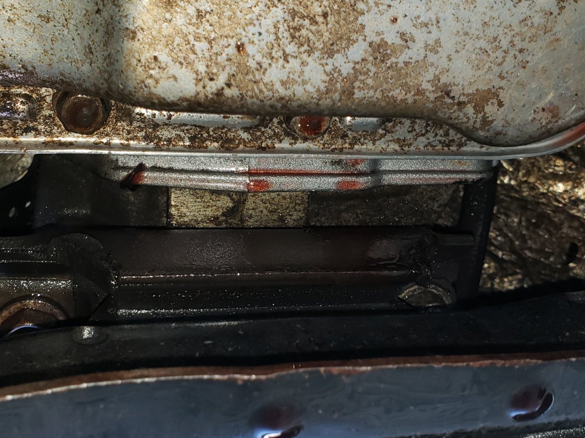

New front driveshaft (after lift) vibrates like crazy 40mph to 60, then NOTHING above 60. Driveshaft company says the shafts look fine, no issues, quality parts, proper lengths - but 2 bolts have backed out 2-3 threads on the front shaft.

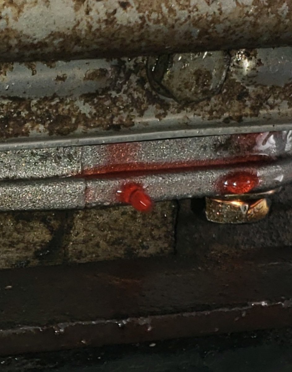

Tech notices a leak between the xfer case and trans.
Get to the local shop that installed the lift/front shaft to inquire about the vibration/loose bolts, put it up on a lift and it's leaking like mad...

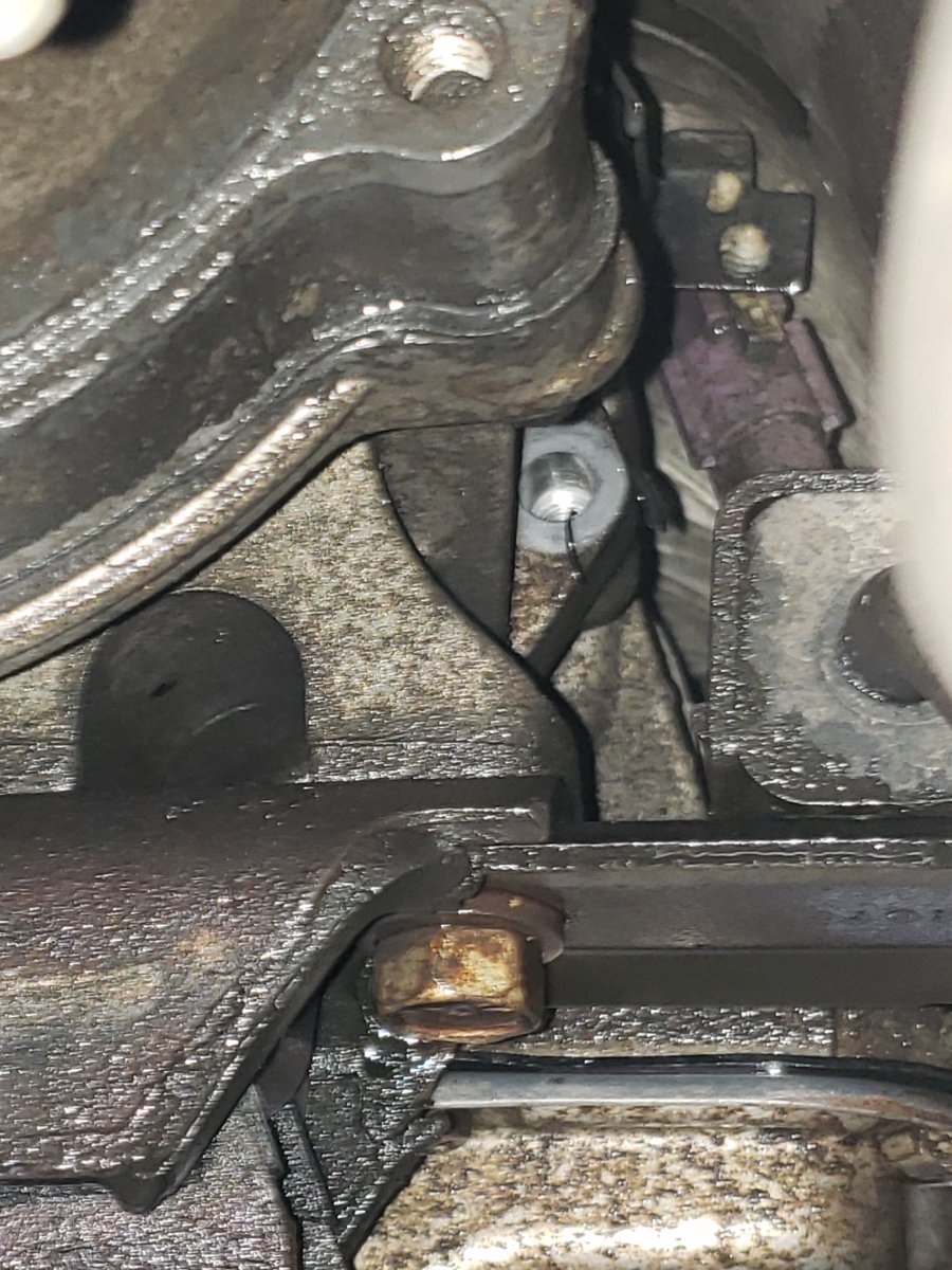

Almost ALL of the bolts from the trans to the adapter housing, and the housing to the transfer case are MISSING.
Before the vibration, we had a couple instances were the xfer case would go into 4High, but not 4Low, or 4Low would engage ("THUNK!") but the 4Low indicator would not light.
Shop procured the proper bolts and is putting in all the ones they can reach first, then dropping the trans crossmember with the trans supported to check the top.
I've never heard of this, THEY were stumped, but a web search shows many such instances...
WTH?
