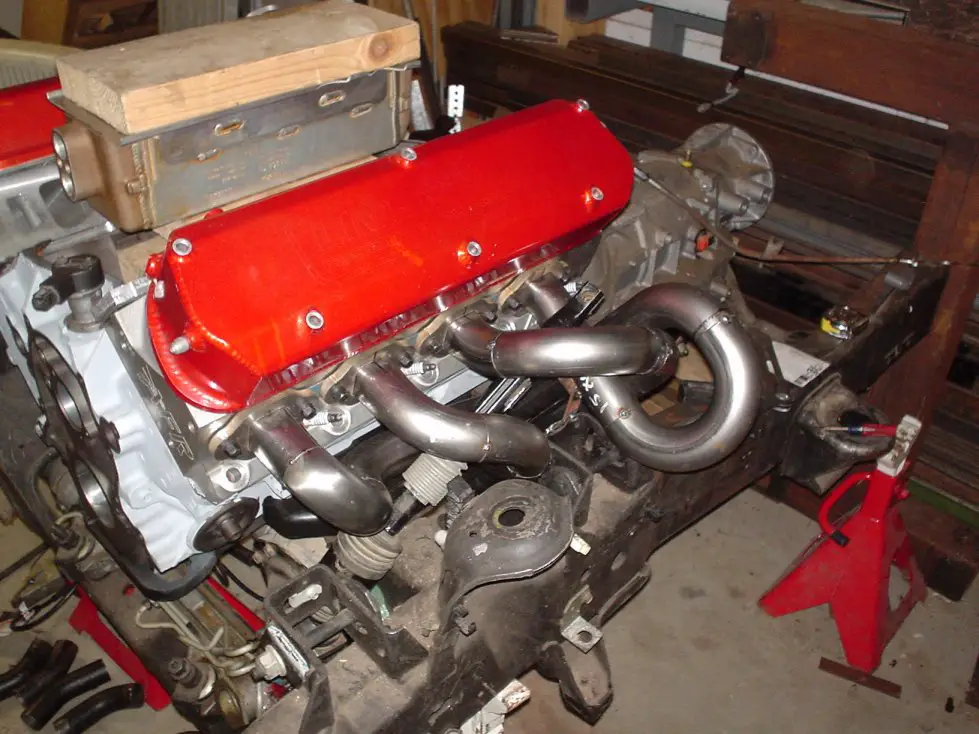

Who made the headers? Are they custom made or?
Custom Headers, made by Exotic Exhaust Fabrication in Hiram, Georgia. Matt does wonderful work. In addressing temperature control under the hood, I had them thermal coated, with FireSleeves around the steering shaft and fuel lines.
Are those sport frames the same as the full size explore? I'm building a 2000 ranger and the only thing that fits is the torque monster headers..so.. I'll need to have a set of at least 1 5/8 built for my 331 with a blower
A 331(332) engine, with a blower, that will need 1.75" manifolds for sure. You might call them(EEF in GA) and ask if they could make a shorty, even just a manifold to fit the Ranger/Explorer, keeping the collector near but not necessarily at the stock location. I've looked closely at the left collector space many times, it's a tight space there given the shielded fuel and brake lines along the frame. Fitting a 2.5" pipe is tough, maybe it can work, the heat getting through that shield is hard to predict. I'm aiming at making a 1 5/8" log manifold, not straight or fancy, just fitted around the steering shaft as possible. A 2.5" collector is going to be hard there, plus routing around the front pinion and u-joint. To fit something bigger, like 3" pipe, I see the fuel and brake lines having to be moved. I've considered what it could be like to make them go through the frame, and up through a hole just behind the UCA mounting.
Yeah man, there is just no room in there little trucks. I may just do a foxbody again. But, again..everyone has one. Not taking anything from them, I've had a gand ful of them and love them. I'm just going to finish this one up, make sure it rides good to my standards.and enjoy this one for a little bit before I jump into a another oroject
What CDW6212R said; you can gain some wiggle room if you are willing to change from the stock collector location. Also since mine is 2WD I was able to have more room to work with. On the Rangers, other than the steering changes that I'm aware of, I will defer to others who have experience with them to better guide you!
I believe the Rangers with the torsion bars have basically the same front frame as the 98-01 Explorers. I knew a forum friend over ten years ago who had a front Explorer frame section to mock up his 302 install, and part of making 1 5/8" headers for it. He quit on the headers, started some 1.75" headers for a 351W, and ended those due to the collector outlet on the left side. His Ranger was a short bed of about 2001 also, orange/gold, with a KB blower on it.

97 and below rangers, were tortion bar trucks. They have more room that the coil spring trucks. Mine is a 2000. I honestly believe,would almost bet on it that if you moved the fuel lines on the ranger you could have some good.headers made. At the very least some 1 5/8 shorties. I can always have outside the frame headers made..but this is a street truck and that is not an option on this one.
Sorry, didnt mean to.clog up the OP thread
83-97 Ranger 2wd and 4wd TTB twin traction beam with COIL SPRINGS
98-11 Ranger 4wd is SLA suspension, Torsion bar is the spring
Yes the 98+ Ranger SLA frame is nearly identical to the 95-01 Explorer frame (until the B pillar anyways)......
Moving the EVAP and fuel lines is not difficult, heck the 05+ trucks already have the fuel line going up the spine of the transmission

Yeah I know they all have coil springs, just easier to call it I beams or coil springs trucks. The ranger crowd knows the difference
What are those fittings called to put on the stock fuel lines? I."may" see what's involved in moving them..then I could.have some good headers made in frame

Unfortunately the four lines running there along the frame are hard lines, three steel and one aluminum. The large AL one is the emissions line going back to the fuel tank charcoal canister. That one would be easy to deal with. The two fuel lines end up near the UCA rear mount, and the brake line runs up to the ABS module. Those three would be tough to move.
I was considering if it had to be done, I'd remake those and bend new lines to stay inside the frame, through the boxed part where that heat shield is, and come out a hole cut in the top of the frame near where the originals go now(where the UCA bolt is hell to get in and out because of the lines). I have cut and flared brake line ends about five times, very carefully each time, without leaks. It is not easy, but with care can be done fine. But that is not a desired project, I avoid doing those critical flares.
The fuel lines will be relatively easy to make that change, because for much higher power, larger fuel lines are required anyway. If you're going that route, when installing bigger 6AN hoses, and fuel filter etc, making the flexible hoses go through a hole in the frame is not a big deal really. There has to be solid mounting of fuel and brake lines to keep them still and safe from wear or crushing.
So the hard part is mainly the one brake line. If you think you can clear out the area along there and cut the brake line around where the fuel filter is, to flare it, and add a new section bent to perfectly fit the frame and come up through it safely, the others are not that bad to deal with. I hadn't thought this all through in detail, until now. But that's really it, if you can get the lines off the inner surface of the frame, then the heat shield can be pushed up against the frame there, say an 1/8" from it, and you gain likely an inch there. The pinion outlet and driveshaft for a 4WD stop you from moving the collector down much. But a 2WD has more space there to work with, to make the turn to the right side.
