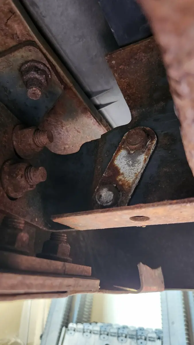

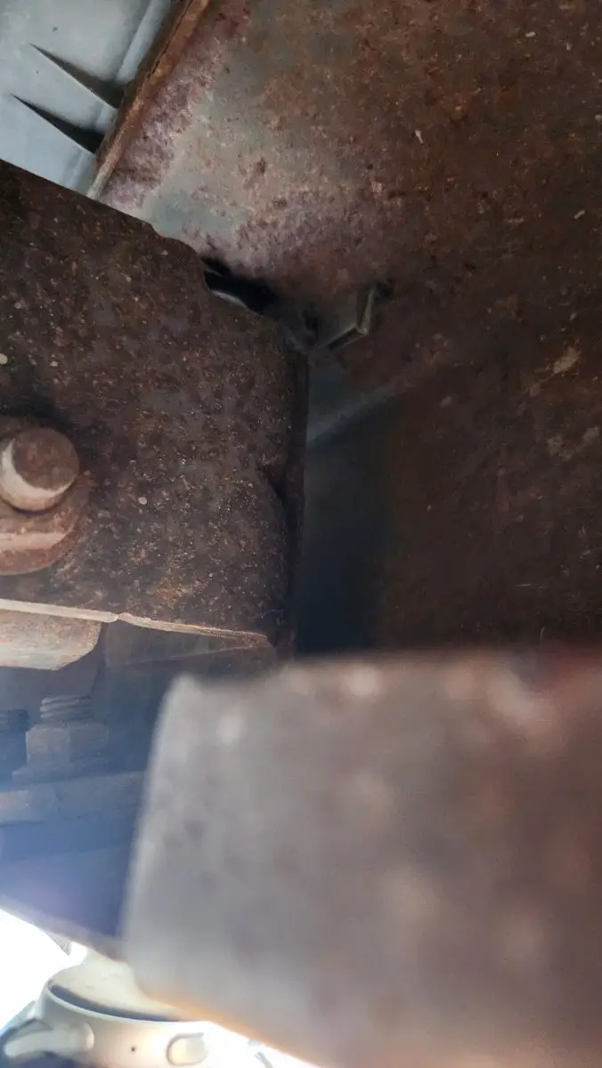

Ok, here's what I found. It looks like everything is bolted securely but you can see that gap between the bumper and rear quarter panel. Also, (it's kinda hard to see) but the driver side is further out than the passenger side.
Pic 1: top looking down. Driver side (left) looks farther from body than passenger (right)
Pic 2: (reversed due to camera) driver side rear bumper gap from body
Pic 3: underside of driver side rear bumper mount looking out from center of vehicle
Pic 4: underside of driver side rear bumper mount looking towards vehicle center
In the third picture It looked like the bracket is crushed a little. The bracket should be 90 degree bent.
What about the other side bracket? Please label the pictures or give a index. Thanks
Picture 1. Looks like driver side is lower.
Picture 2 . pass side gap.
Picture 3. Driver side bracket, looking outward from under the vehicle looking out.
Picture 4. Driver side bracket, looking in the direction toward the pass side
So sorry, you ar correct on all except pic 2 is the driver side gap. I was under the car and had it in selfie mode and it reversed the pic.
What the gap between both sides?
There is no adjustment in the mounting bolt holes on the bracket.
I guest is too remove the bracket and straighten it out. Presoak the hardware first with PB or equal.
