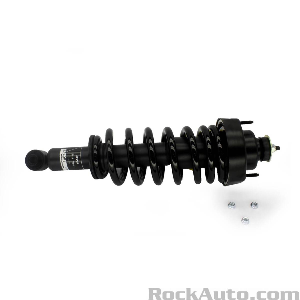

Looks like Monroe Quick-Strut is $441.70 shipped with 5% discount and KYB Strut-Plus is $609.21 due to a recent price hike. I would look elsewhere for KYB's. Part numbers are SR4081 Front and SR4051 Rear.
Amazon has the SR4051 for $107.58 each free shipping.
So if you get the front from RockAuto for $279.76 shipped with 5% discount and the rear from Amazon for $215.16 shipped it comes to $494.92 which is $53 more than Monroe.

For anyone wondering I ended up going with KYB strut-plus all around. Thanks for all the good info and opinions. I contacted Monroe directly about the variable/constant spring and there responses were so off I decided against them completely.
