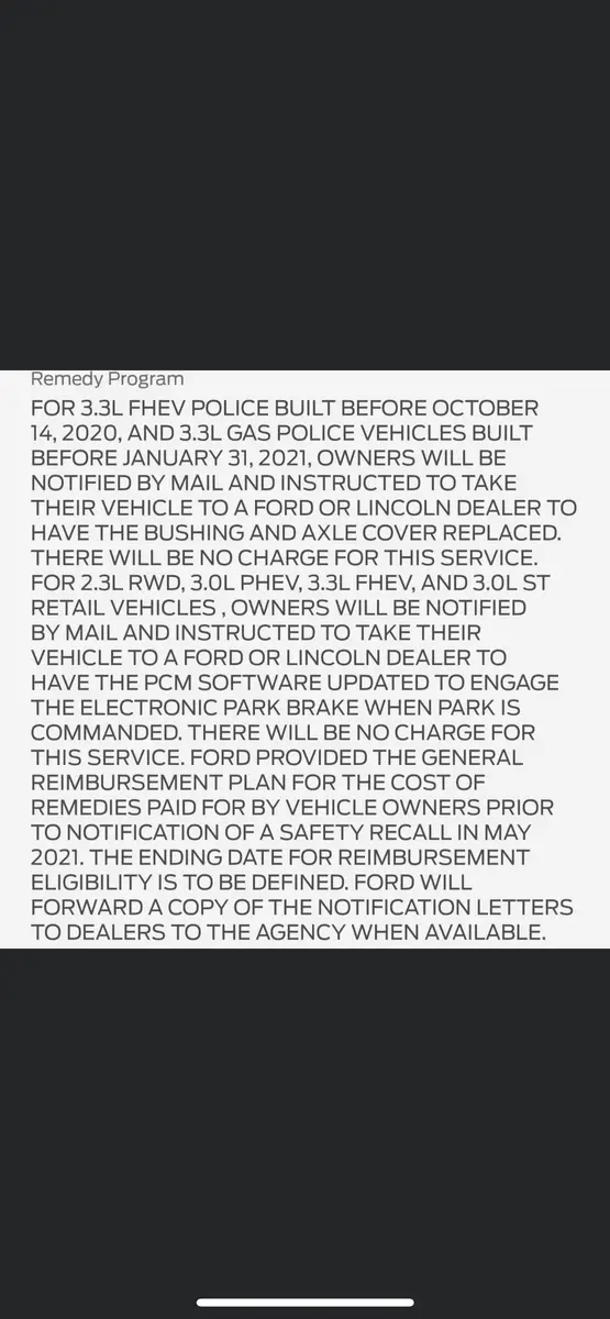

Makes sense. Appreciate the really good explanation.In a way yes, but the bushing as you can see is not there...there are different part numbers for the sub frames. If you want the 2 bolt rear sub you have to order that part. Can not just throw in a bolt. The 2.3L we likely suffer no downside from this...even towing. It is the 415Ft Torque causing a twist and over time is breaking the bolt. The 3.0L has over 100 more FT Torque than the 2.3L and is quicker at applying the power due to the nature of a V6 and the twin turbos.
