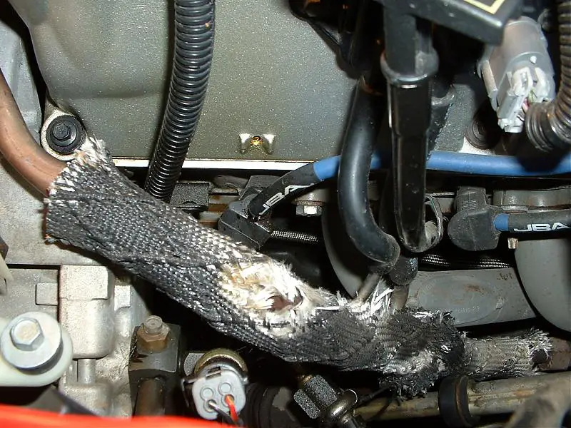

I had a big scare yesterday. The rear 02 sensor harnesses was not wired up out of the way (this harness is not being used anymore) and it fell on top of the exhaust and melted. It made the truck throw 11 codes and run like crap. After I located the problem, I fixed and everything went back to normal. – Just a little hiccup.

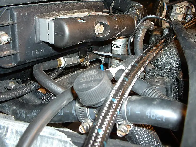

First pic is the check valve and the STS actuator valve for the PVC system. *note - didn't use the sts supplied check valve.

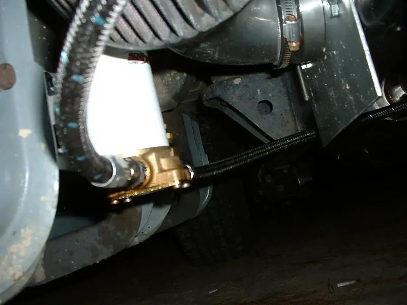

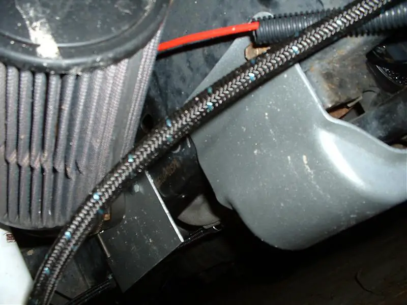

Next pic is where the oil is returning from the turbo. These lines are the Russell pro classic hoses.
This is an attempt to show where I'm feeding the the turbo with oil. I used the oil pressure sending unit for this and t'd off it. The feed line is 4AN line I had custom made (60" long to get to the turbo)

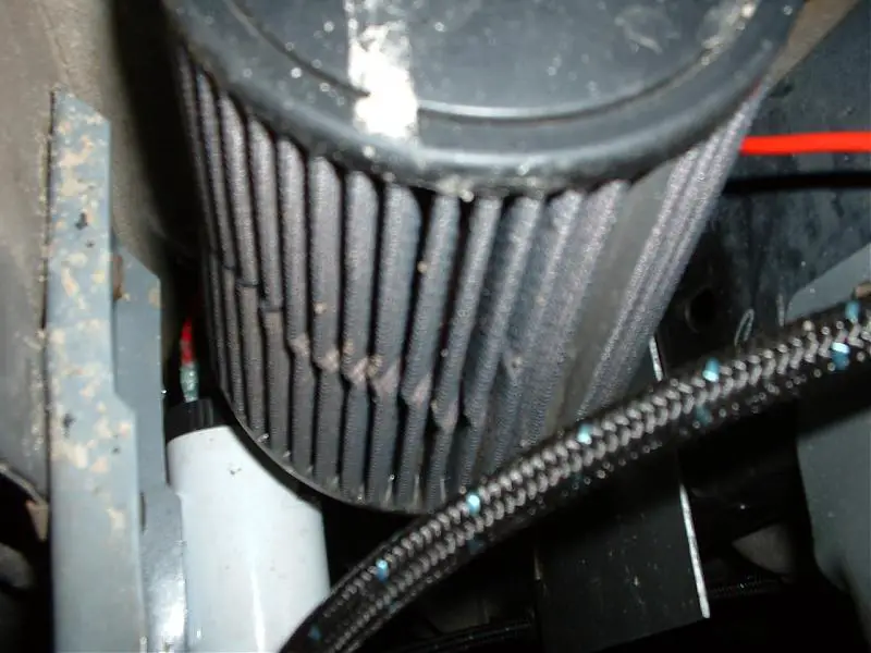

Next is a close up shot of the dirty volant filter that I need to replace. This part of the set-up needs attention. I need to figure out somehow to close the filter in to protect cuss it's behind and inline with the front right tire.

This is where the oil pump is located. Look to the top right and you see where I had to come thru the frame with the intake pipe to the turbo. I'm laying right behind the right front tire to take this shot.
Another shot of the filter and frame plate support for intake.

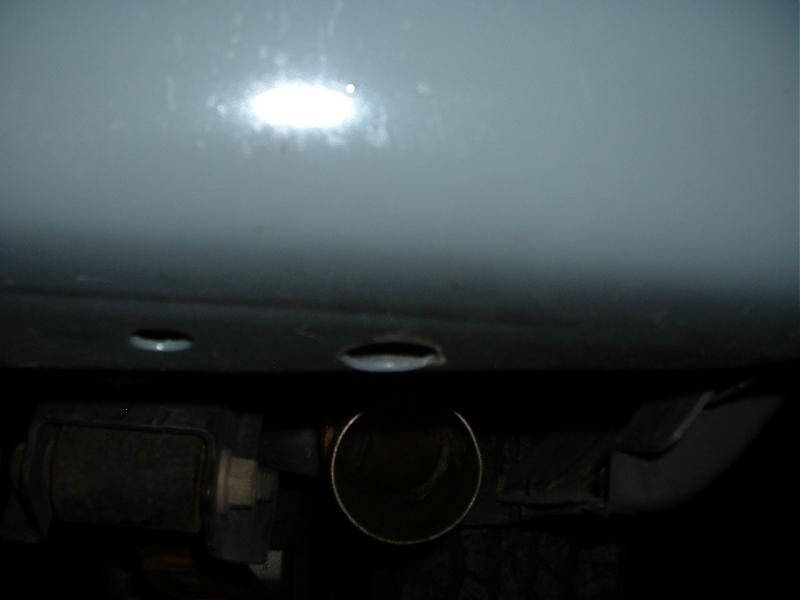

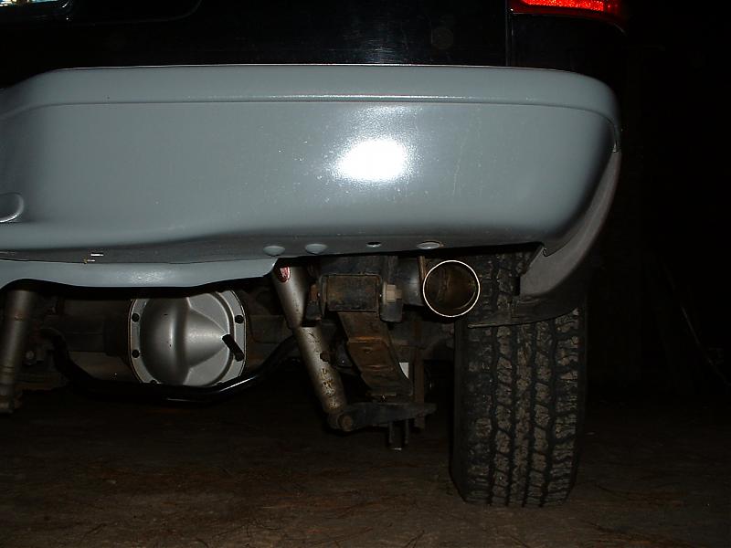

Tail pipe coming out the back.
Tail pipe coming out the back....(And what you'll see if you line up with me......JUST JOKING!!!)

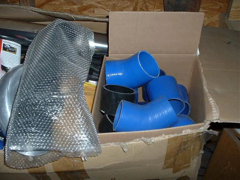

Couplers left - I just couldn't get into the "blue" couplers so I replaced with black.

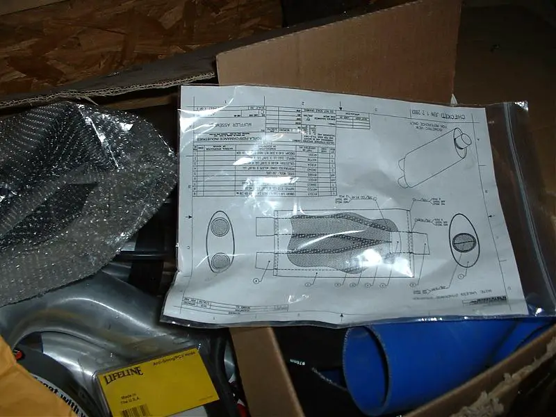

Borla pro XS muffler print. I finally got the sound I was looking for by going with this muffler. The more it "wears in" the better I like it. FINALLY, after three different exhaust set-ups!

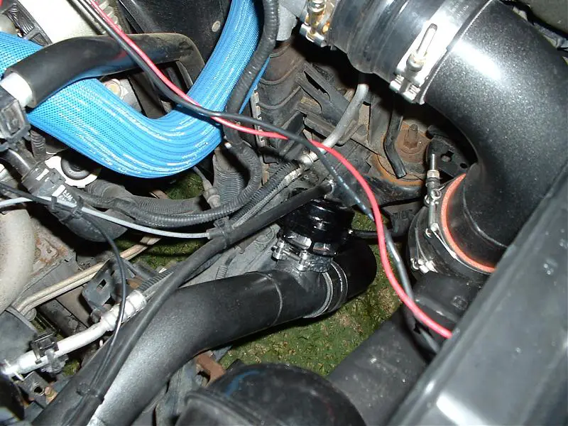

Engine bay. Most of what you see here is a temp job. The MAF and intake tube into TB is being replaced so I just plugged in the Hobbs switch for the time being. *note - I started replacing all the "Blue neon" hose cover I had....I thought it looked to "ricer".
Tail 50MM BOV.
This is the charge pipe coming from the turbo, and where the 2" to 2-1/2" transition occurs.
