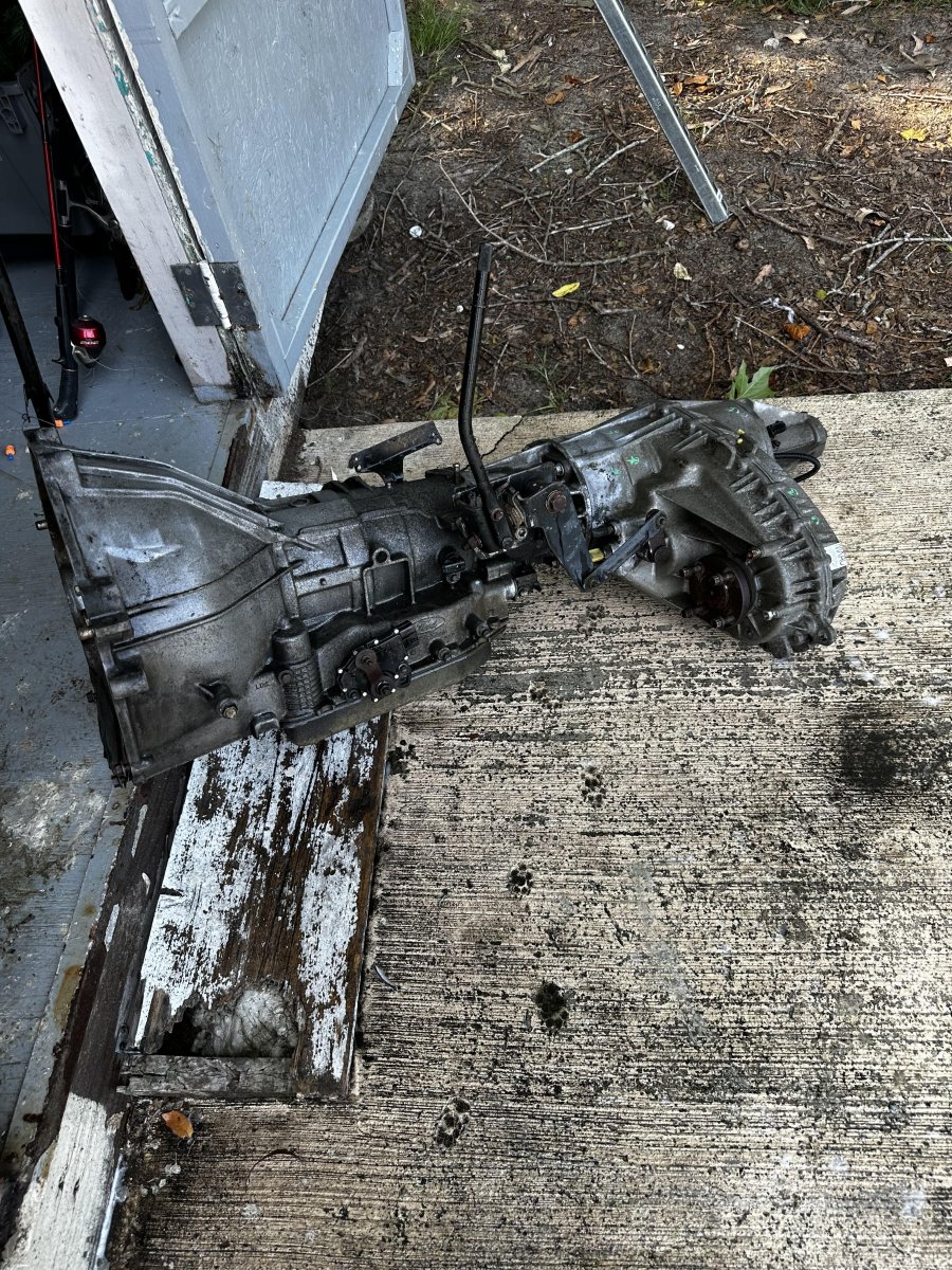

Back to taking a stab at this crazy adventure, finally collecting parts, and a have a few questions.

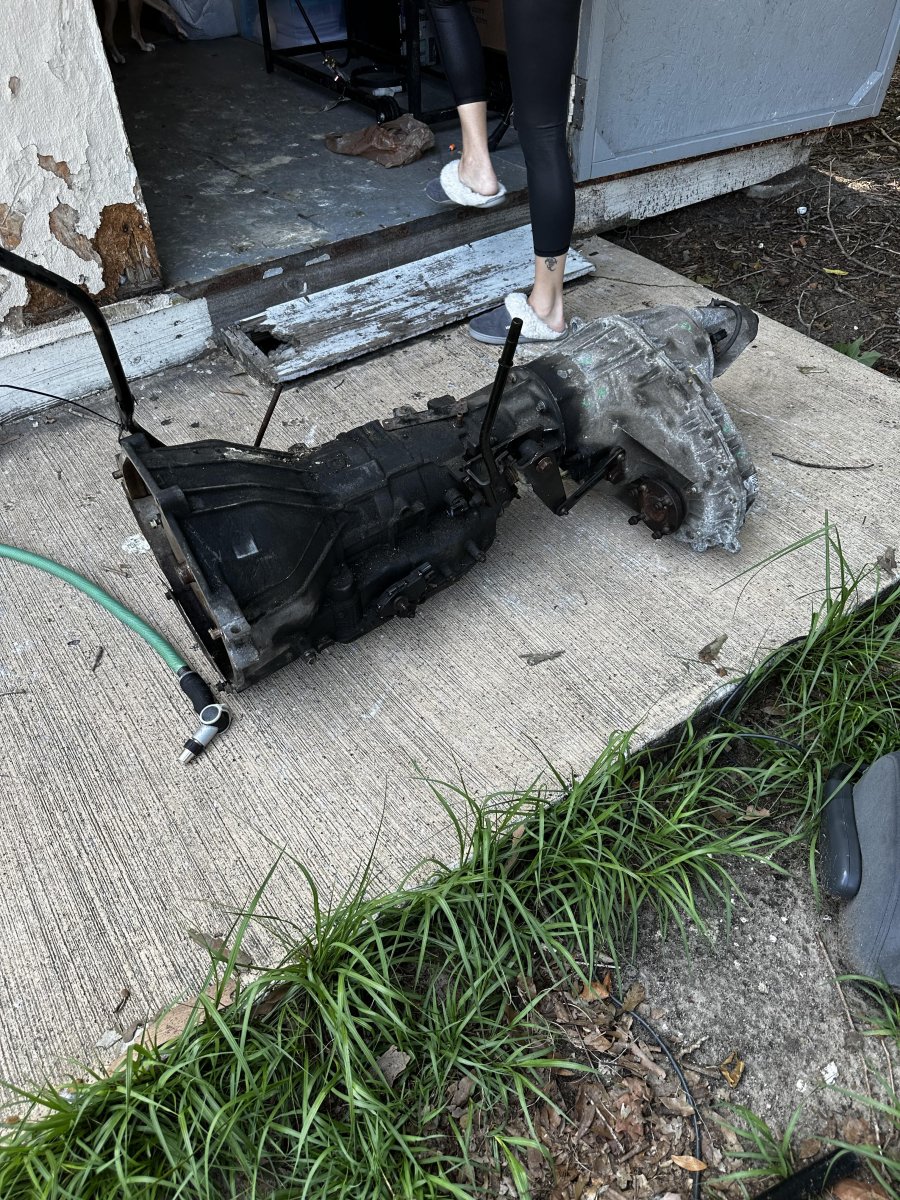

I found a 4R70 and a 4406 with the VSS in the tail shaft, I think it was a 2000. I got the linkage and boot, but the knob was missing. Im getting ready to try to stab it in there which means ill have to make a few modifications.

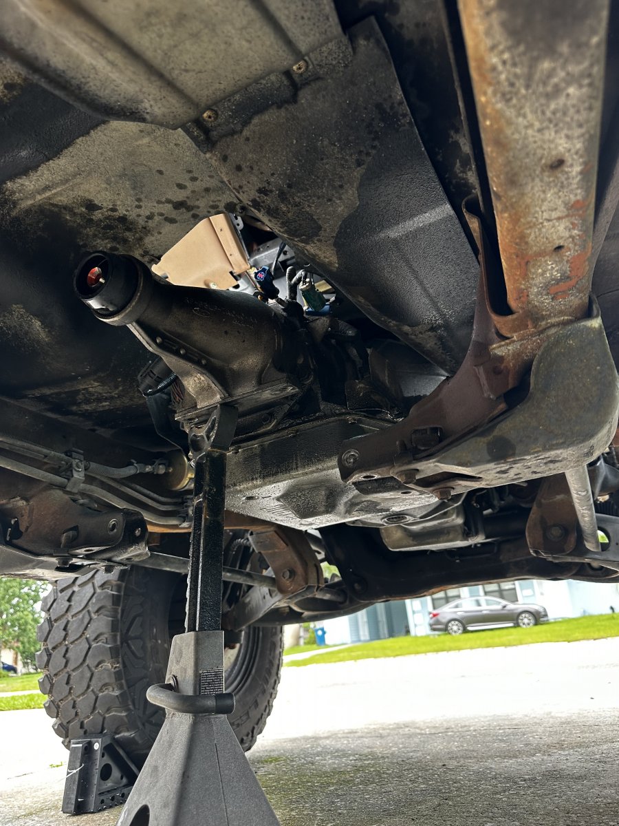

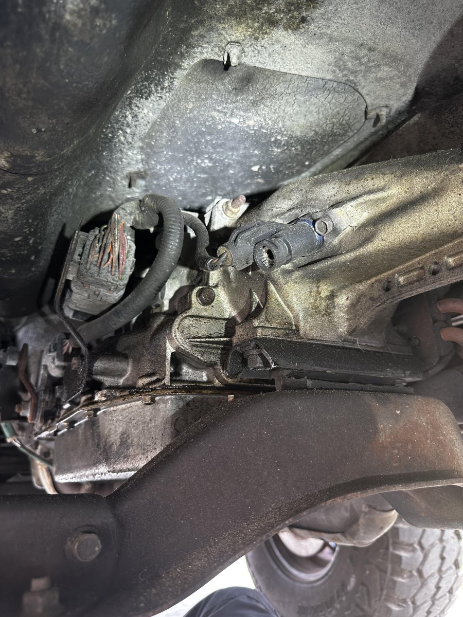

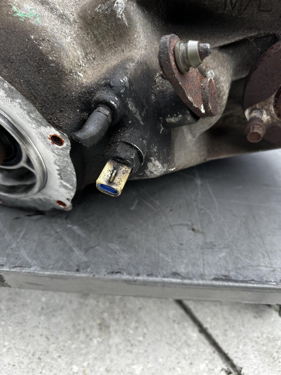

On the 2wd trans the vss looks a little different, and its way further forward, so I'll have to extend those wires, but the plug looks the same, not entirely sure why they look different. I'm assuming the sensor on the front of the xfer case is a position sensor so it will light up the 4WD light and probably tell the computer something. So can I just ignore that one? Also the singe out of the back, no clue what that connection is, maybe temperature? The electrical on the trans all looks similar so that should be easy.
Now I got the trans from a junk yard, no way to test it without putting it in, that I know of anyway. So I wanted to possibly throw in a drive shave from an expedition just to test, just not sure its going to work as i went spring under, so the length is a little longer. Does anyone know the measurement of the expedition shaft? I did look through a few threads and didn't see it. If i have to have a shaft made I will just get the sterling installed where it will end up and have a shaft made to fit that.

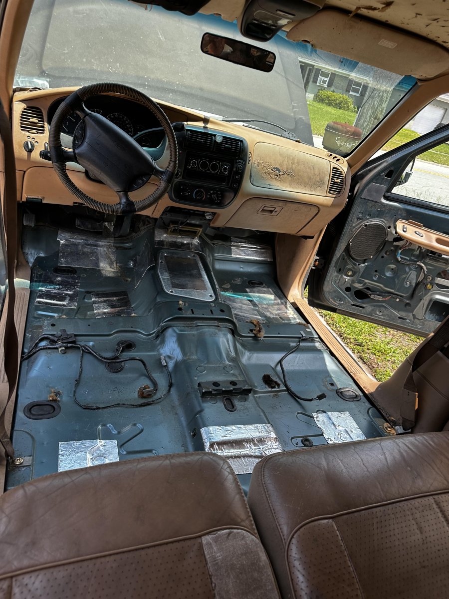

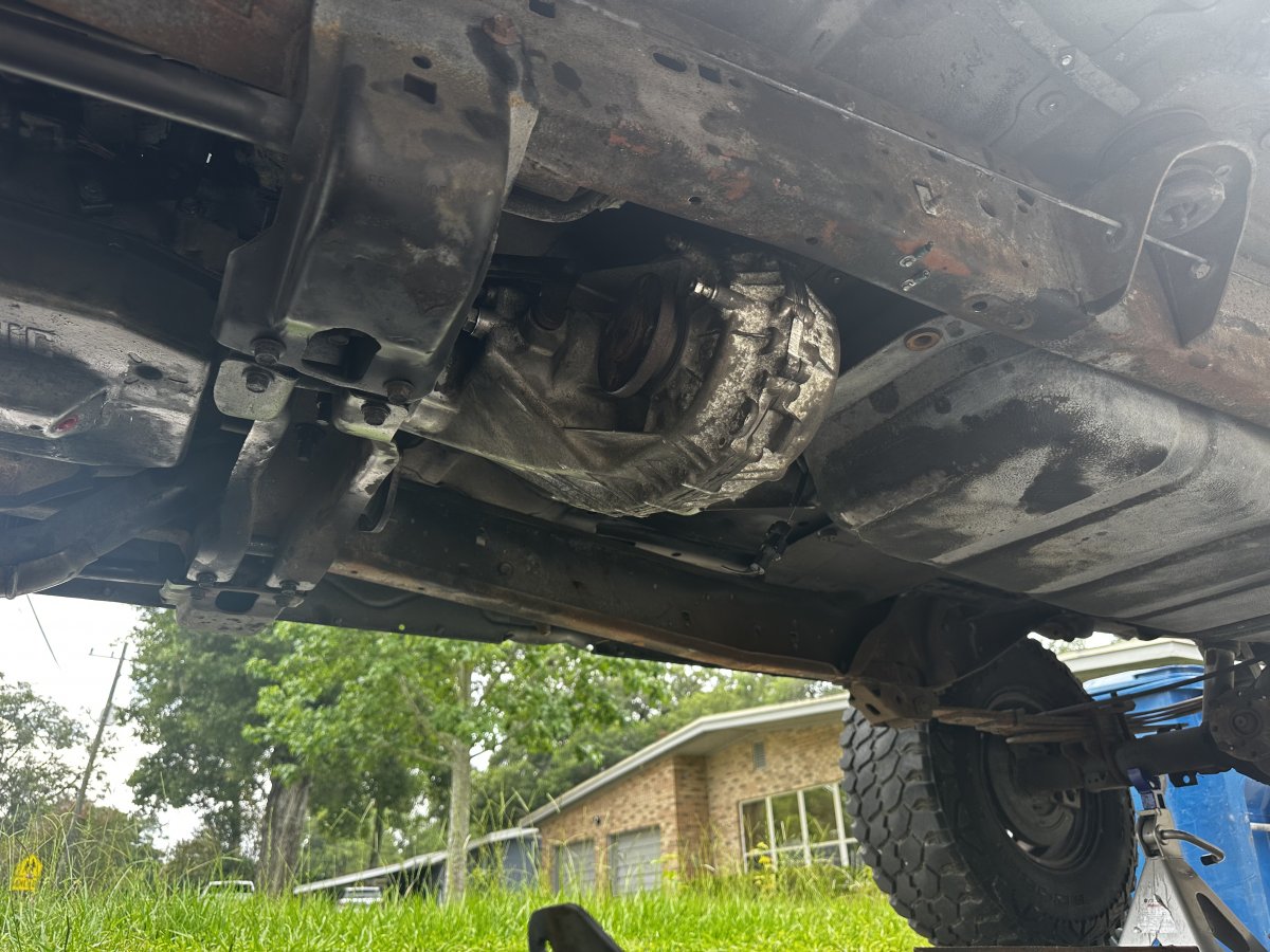

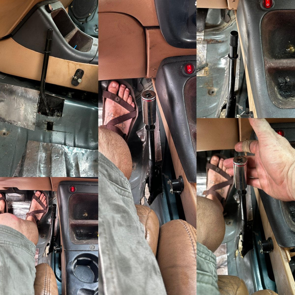

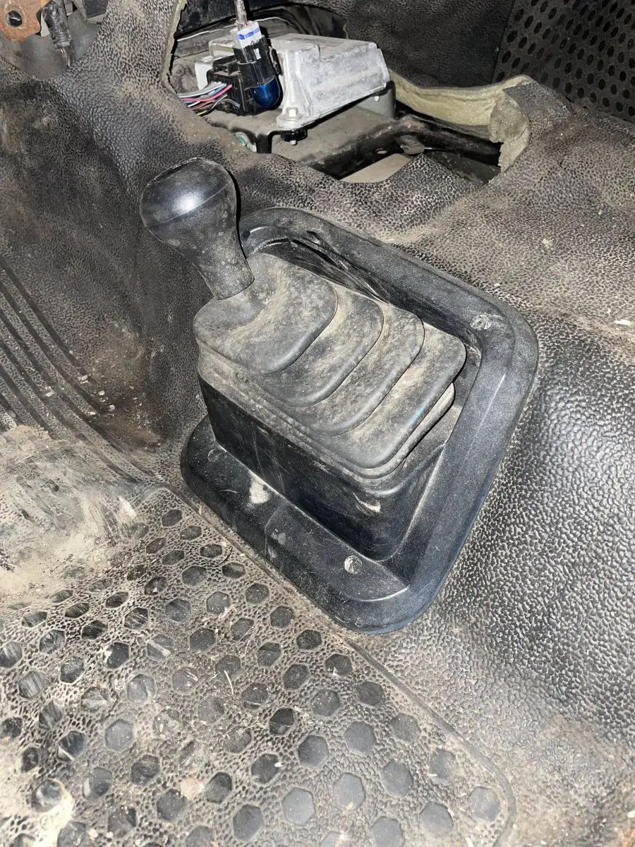

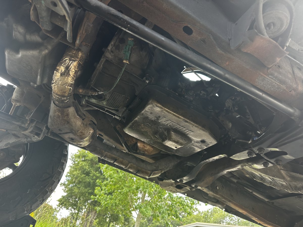

Took some measurements around the tank, looks like the front bracket is going to need some heavy modification, and the tank itself will probably get a hammer treatment. Not sure if they are the same from 2-4wd. Also measured approximately where the shift lever is going to end up, looks like there's already a panel there! I dont recall that beaing mentioned anywhere.
