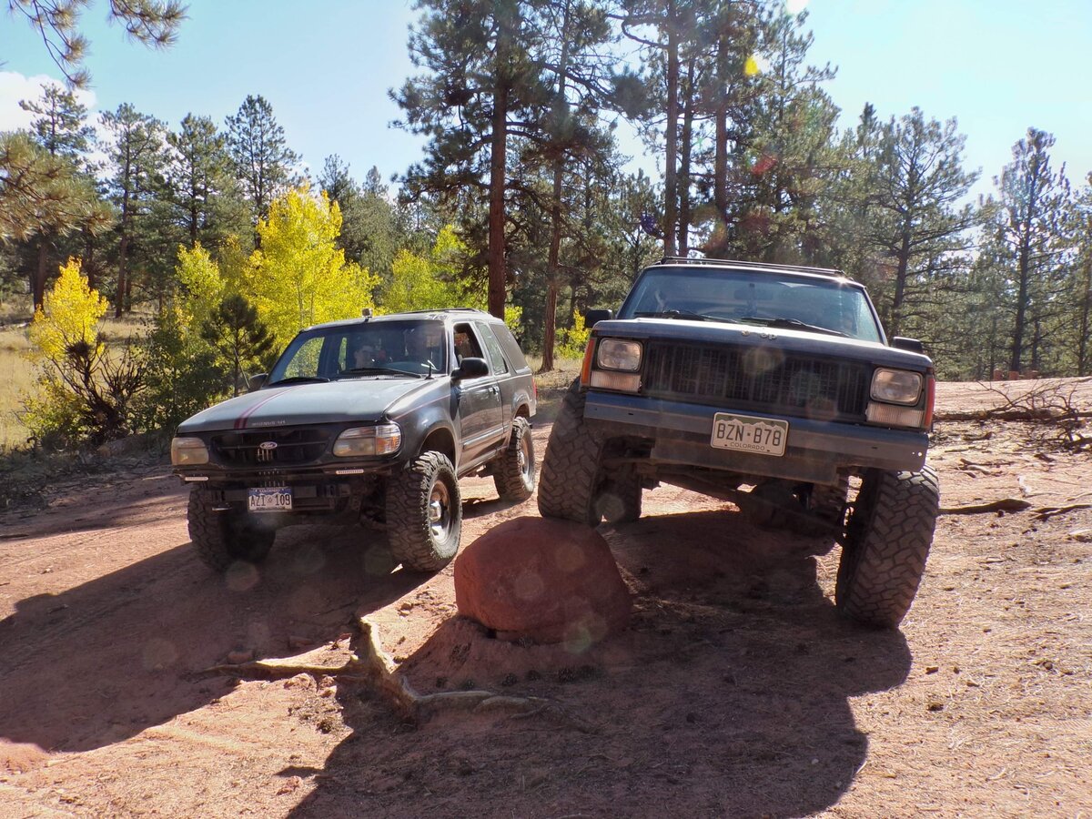

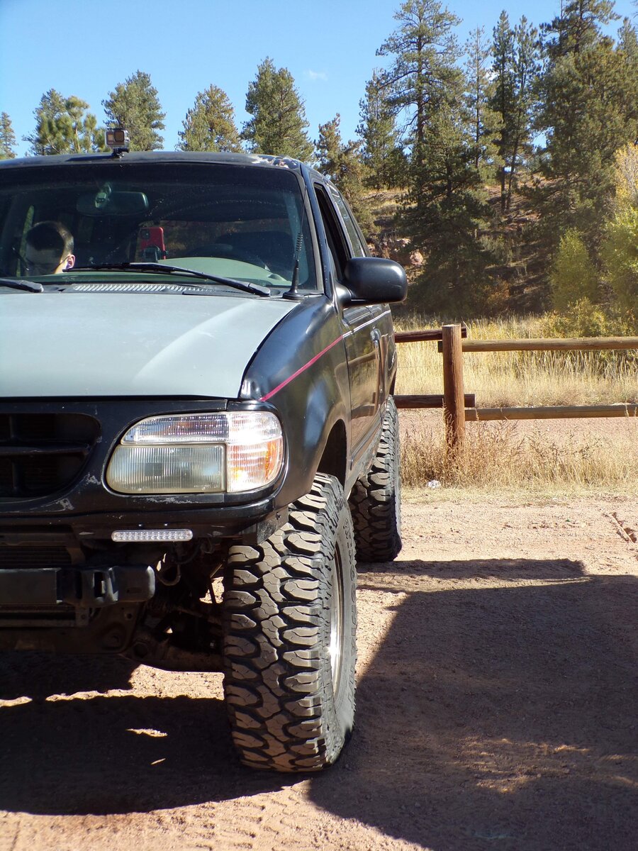

Okay, so I'm finally doing this, going ahead within the next few weeks with new tires, wheels and some suspension replacements. Have everything for the front end suspension (detroit axle), even getting some new torsion keys. For the rear though, I already have the warrior shackles on her, found via searches that the shackles plus the lifted leaf springs are too much? So, would it be better to get new stock leafs with add a leafs and the current shackles, or go with the 1.5" lifted leafs with stock sized shackles? Working on fitting some 32" tires while also fixing some dying suspension. Anything is appreciated, even other ideas
I have Keys and add a leaf and Shackles and I am running 285/75r16 roughly 33's. I also do not have a front bumper and trimmed the rear and have a 3rd gen rear bumper. Not a very good side view but here she is. I am happy with how she rides.
View attachment 423597 View attachment 423598
She looks good! think I'm going to end up with the same lift setup. You can fit a 3rd gen rear bumper, really?
Yes you can it takes a little drilling but yes it can fit. Here is a close up ish of it. When I get home tonight I can get a better picture of it and send it to you. This one I had it upside down. I now have it right side up.
