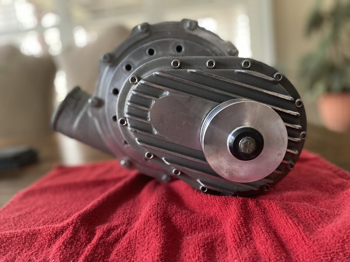

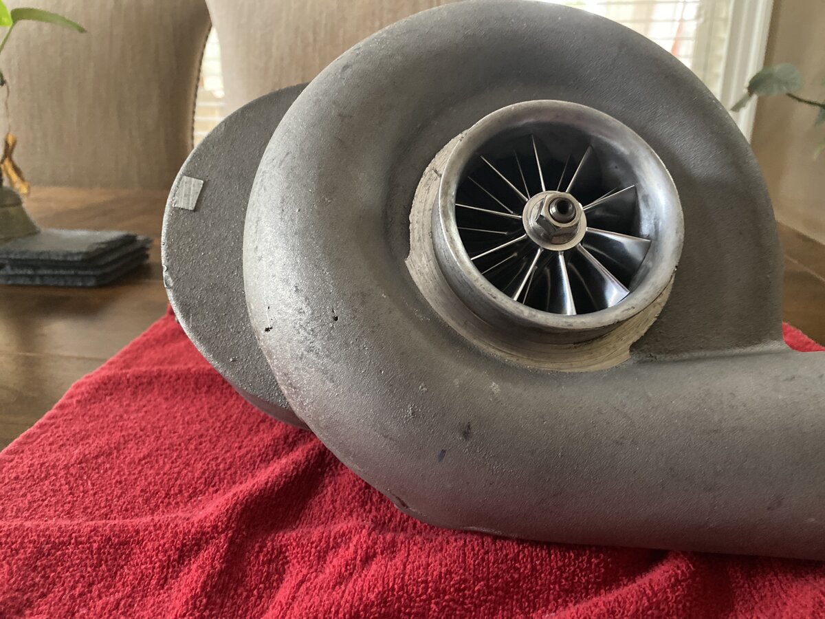

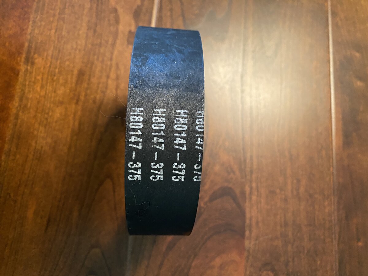

As you may have read, I had my Ford Motorsport SVO Powerdyne Supercharger fully rebuilt by Jon Bond Performance (including new billet impeller) due to a bearing failure (my fault)

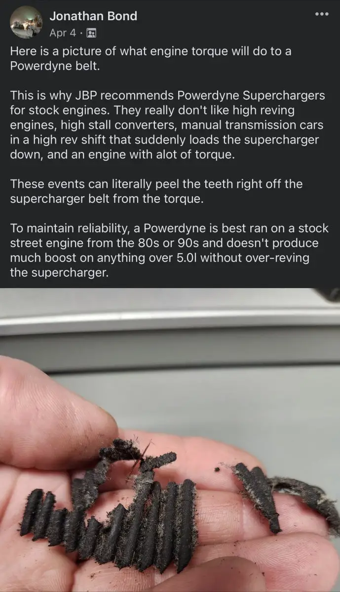

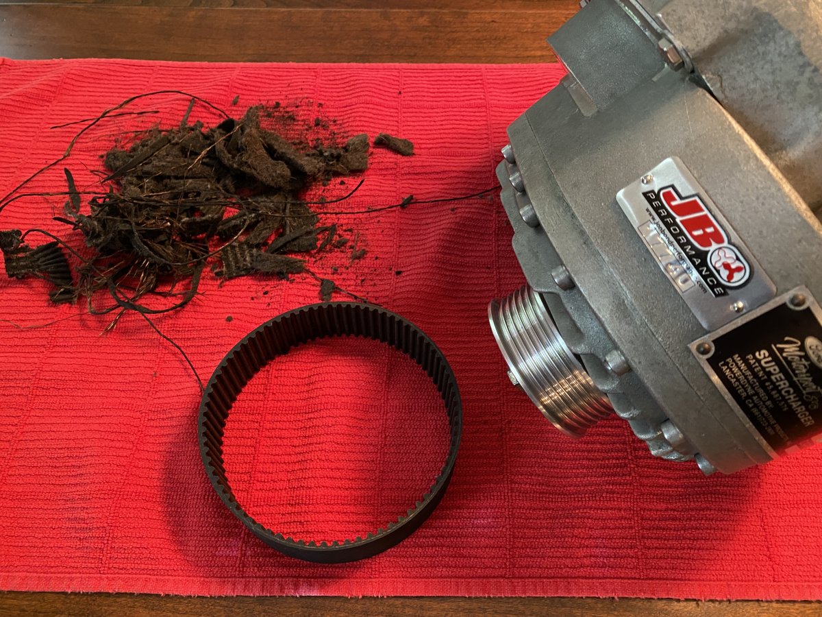

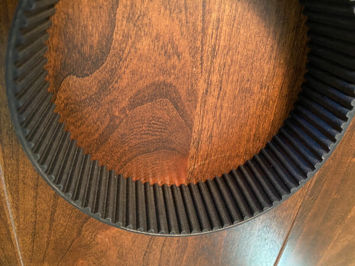

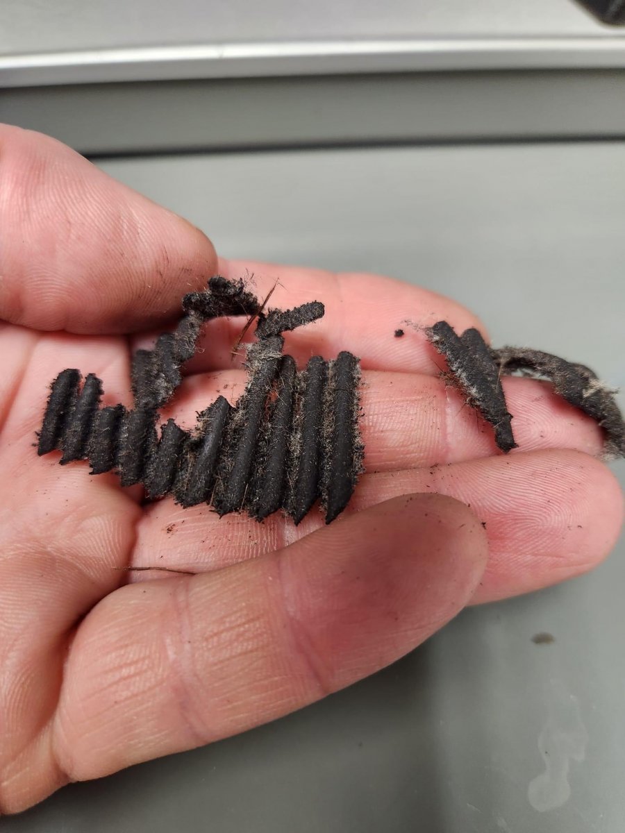

After receiving it back and going back to the 2.8” pulley (with the 5200 rpm shift point this keeps the blower under 38k rpm) the blower has failed at less than 100 miles. I suspect that the internal drive belt has failed as the input shaft spins freely but the impeller does not. You can turn the impeller manually by hand freely and there is no sign of damage.
I let the team at Jon Bond Performance know what was going on and I’m shipping it back to them for inspection.

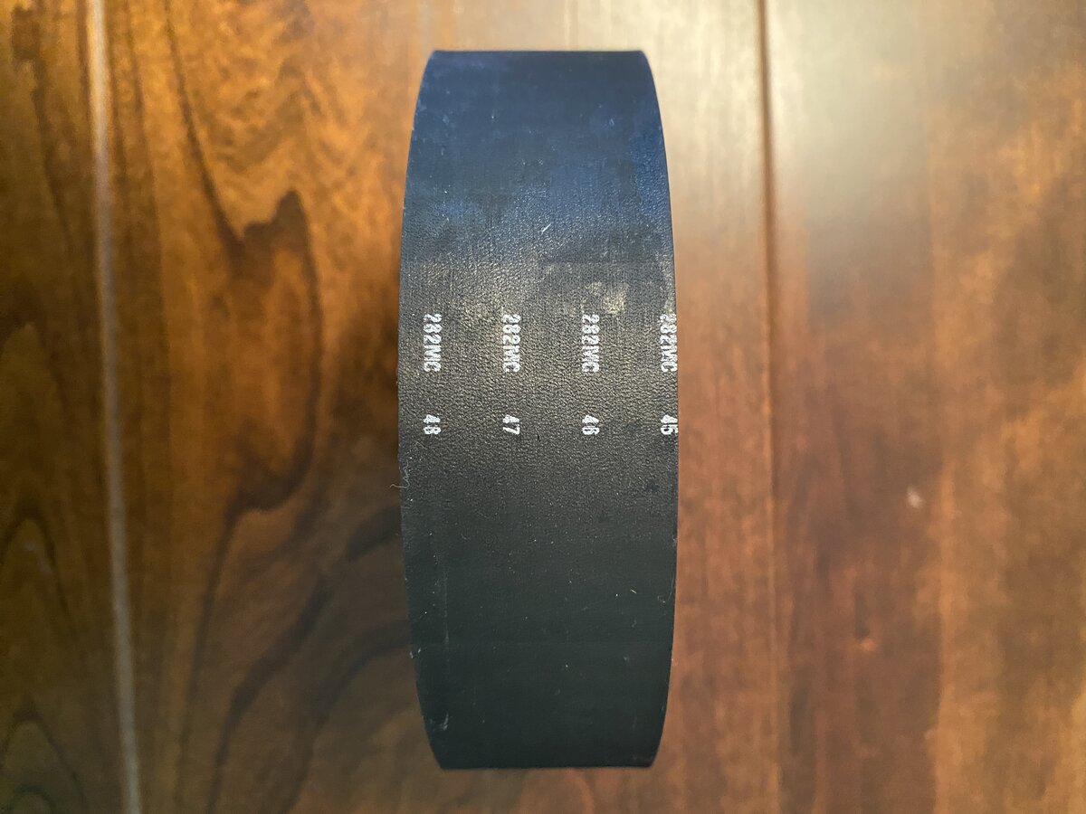

If the (new) internal drive belt snapped, I’m really not sure how it could have happened. My setup is installed on a 5.0 WTA intercooled motor, uses a properly installed Bosch bypass valve. The truck is an automatic and is set (by tune) to not shift higher than 5200 rpm. The blower pulley is 2.8” (actual 2.86”), the blower crank pulley is 6.5” (actual 6.485”) and using the appropriate formula I calculate that the blower does not spin higher than 36,818 rpm at the 5200 rpm shift point. The previous OEM belt that was installed on the blower was found to be in great condition during the rebuild.
I’m hoping the inspection will shed some light on this mystery and hopefully help discover what needs to change (if anything) to prevent this from happening in the future.
