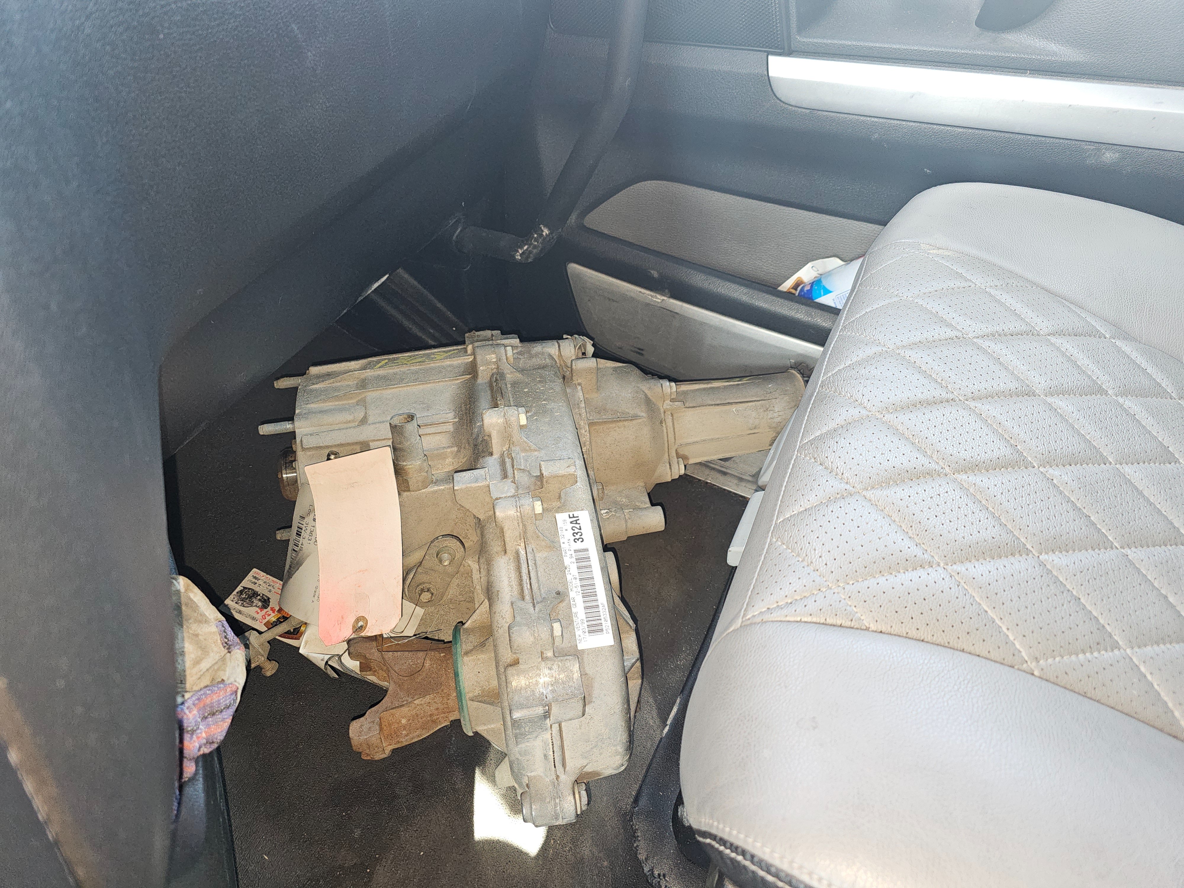

T56 magnum. I'd use the corvette extension housing so I could mount a transfer case to it. I'd get the wide ratio trans with 2.97 1st and .5 6th.

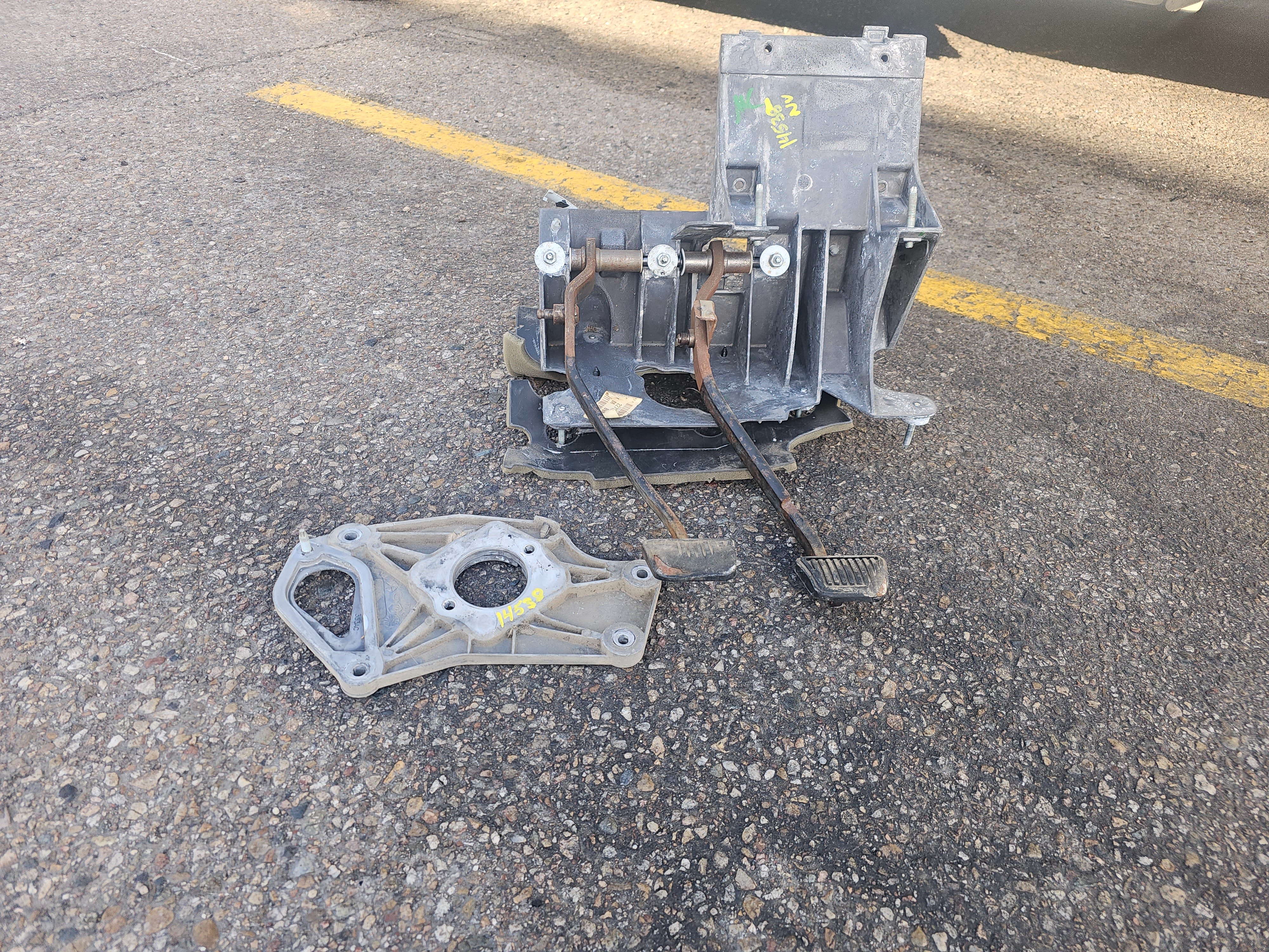

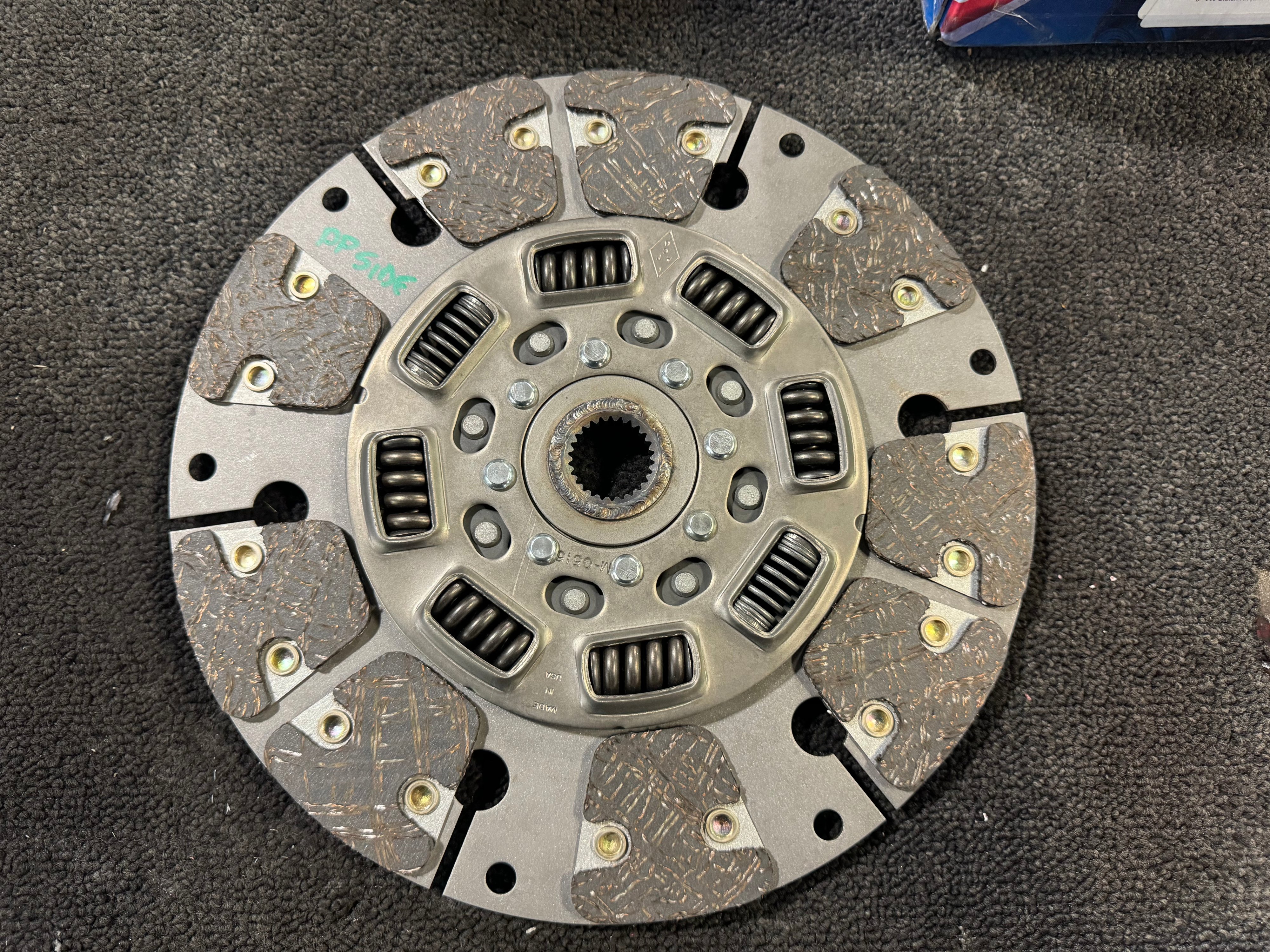

I have given up on getting a flywheel drilled, asked several places, what's the worst that can happen and got the same response. It can come apart. The SAE 2 adapter won't fit and an 17 inch clutch is overkill for the V6. I'm going to see if I can have a bellhousing made to fit the ZF manual adapter plate, then I can use the 6.0 flywheel.
Something else I've thought about that I need to take into consideration is an 11 inch clutch probably won't be enough. Stock power is fine, but I'm looking at turning it up as high as I can.
