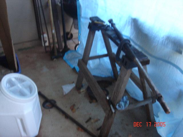

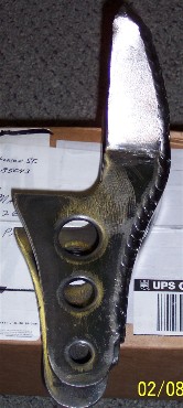

My mount, and I'll try to get a pic of it mounted tomorrow if it's not raining. I thought I had one but can't seem to find it right now.
Nice mount did you make that or purchase it.
FROADER said:
It's from FST where Rick had his truck done. Felix, the guy I bought the X from got it from there.
Any idea on the price on this? I don't think Felix even visits the site anymore, does he (so it wouldn't really help to PM him)?
Thanks, I found it. Looks like you both have a problem with rain. :p
Quote: Felix
"It was $150 and it is weld on. It is not exactly what I wanted but it will work much better than the one I have at the moment. If it does not rain tomorrow I will start taking my truck apart to install it. The rain has been so bad I couldnt get my truck to dry off enough to start working on it as of yet."

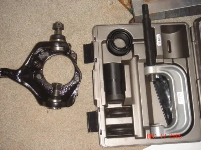

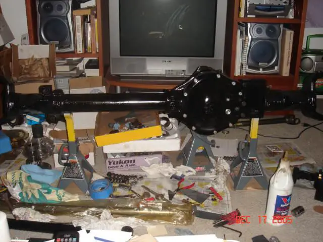

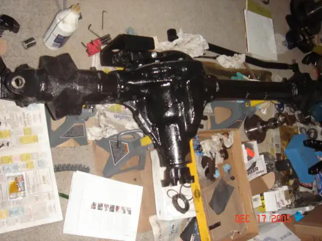

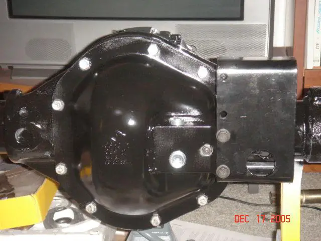

more pics...
and more pics...
How do you guys get away with having drivetrain parts in the house? my wife would kill me :D
The carpet in my apartment is filthy from me walking to and from the back porch where I rebuilt a full width 8.8.
I convinced my wife that if I were to leave my axle and parts I just spent a ton of money on outside on the back porch then it'll rust :rolleyes: :p :D
Plus too, she goes out wheelin with me so its all good :thumbsup: :D
I am trying to keep the carpet from getting TOO dirty with the axle being in the house, but it was already dirty to begin with

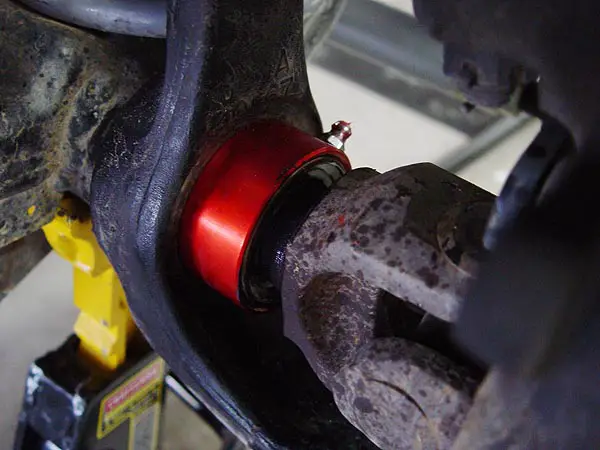

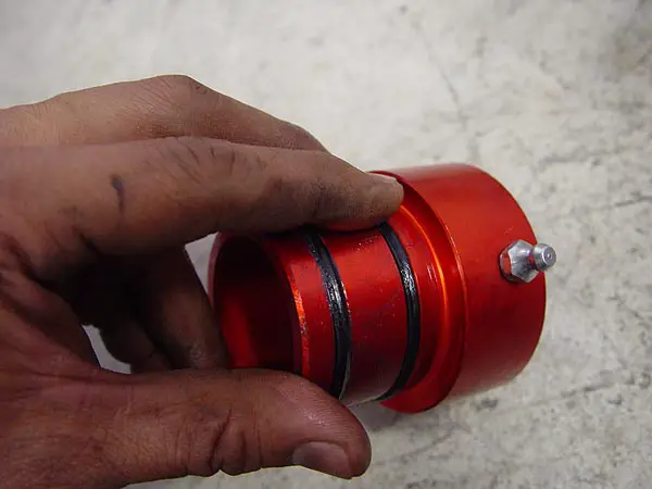

Axle tube seals are in!
My friend finally finished the fabbing of the axle tube outer seals; similar too the ones that alloy usa makes for the heeps as shown here from 4x4xplor website:
I would like to see a picture, I don't like crud building up in my outer axle tubes :mad:
