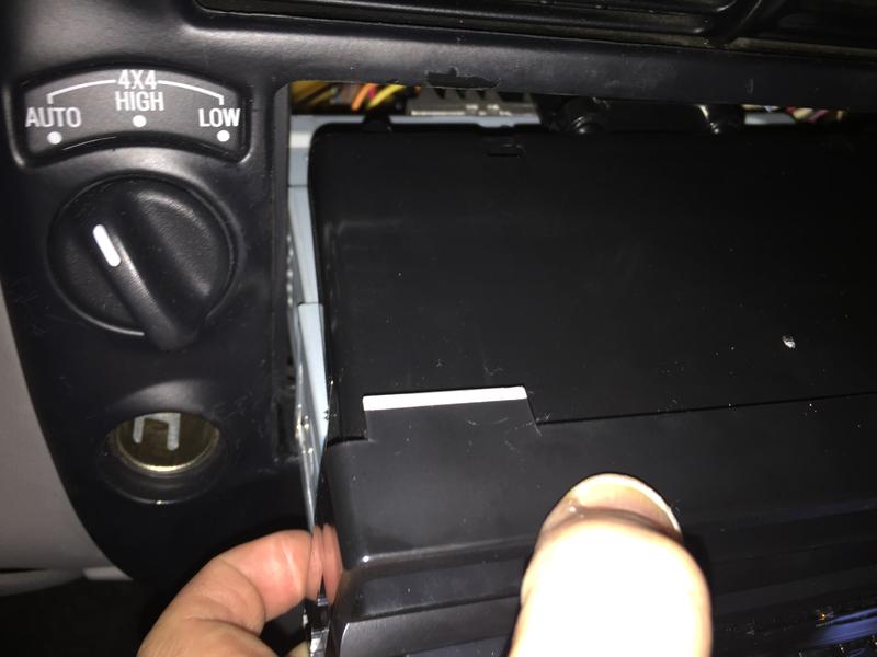

So about a month later here and the head unit started popping out and forward any thought?
Got it figured out there is a tab that I didn't take off of the head unit kit and now with the cold weather the plastic probably isn't as maluable.
