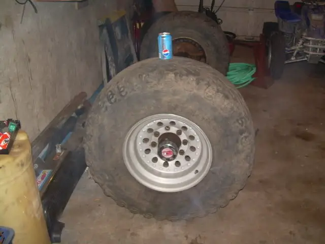

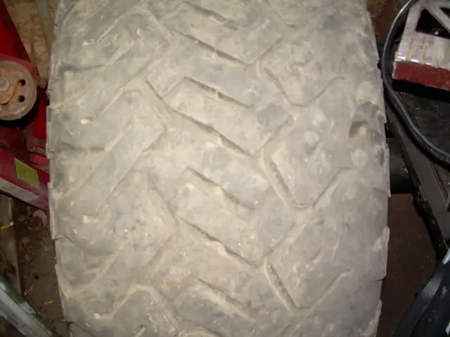

got some free tires and wheels...36x15x16.5 Dick Cepeks on 16.5x10 outlaw II's the tires are bald but will do fine untill i get money...ill get pics tommorow hopefully. I also found out some thing interesting... with 3.27s and 32s i get odd mileage(suprised?)...8mpg around town and 25mpg on the highway...i run 80-85mph at 2000 rpm and i dont hit overdrive untill about 65mph............i almost wish i had to commute...
Ok so i got some pictures of the big D 6-0...it fell off the jackstands while i was changing the tires and damn near killed me...first the tires and wheels i got for free

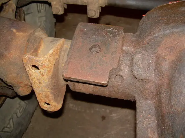

now the width, flat top knuckle....

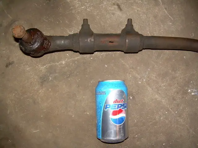

now the stock drag link...

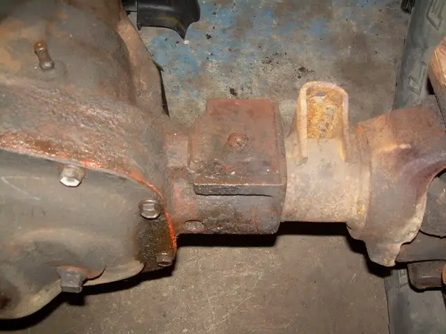

now the reason my leaf springs have to be 36.5 inches apart...
...any body got any thing to say....? good or bad i wanna know....
Can't go wrong with a 60. Just have to swap out the drums for discs.
jackstands suck for holding axles. I've dropped one of my axles off a jackstand once or twice..... very scary. i've got pipestands with v notches holding my good dana 60's, and my 44 and other 60 are on the floor. Did have them on jackstands, but its not worth it. If the jackstands are spares, look into welding v nothces out of flat stock onto the top so they cant roll, and widen the base. except for the stubby short side tube, it looks just like my d60. good luck man.
do you have the calipers and everything? couldn't see them in the picture. I spent about $230 after core deposits on my front brakes. my rear brakes (chevy rotors and calipers were $210 and i didnt even have core deposits.) those massive 2 piston calipers are expensive, and i think we need a f-350 master cylinder to run them.
