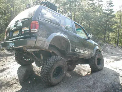

HOLY SH*T!:eek:
that's an awesome picture. i think your explorer has more flex then any other X on the board.
your truck has come a long way from when you first joined. it looks great.
if you go to 6.11 gears, i dont think you will be able to drive it to any trails (a trip to paragon would use up a LOT of gas). you're going to need another truck and a trailer to tow it there.

Thanx...
As per the gas... well I just bought a house about 5 min from Paragon... so that aint a problem now... lol

Looks like you are running the 4 door leaf pack. Did you remove any springs when you did the SOA? How much lift did you get out of the SOA?
Thanks
