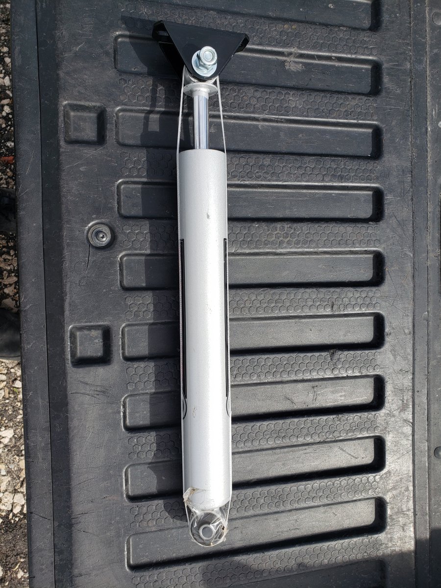

These are the Ranger +4" shocks included in the Rough Country kit.
Installed:
Shocks still had to be compressed just a tad with the rear at full droop.
Very happy!
